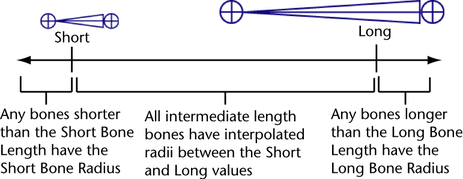

When you create joints, the radii of the joints are determined by the length of their bones. This means that when you draw a joint chain, the radius of all the joints in the chain automatically adjust to the length of their bones. For example, short bones like those in the human hand generate small joints and long bones like those in the human leg generate much larger joints than those in the hand.
Sets the bone length at which a bone is short.
Sets the bone radius of short bones. This is the minimum bone radius.
Sets the bone length at which a bone is long.
Sets the bone radius of long bones. This is the maximum bone radius.
