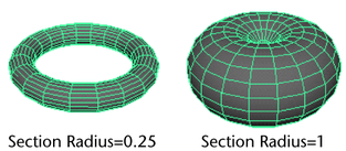

Specifies the distance from the center of the torus in all directions. (For interactive creation, appears as a single-click setting only.)
Specifies the size of the sections that make up a torus. Change this value to increase or decrease the radius of these sections.
The Twist option value specifies the twist angle of the torus. Change this value to adjust the distance around the torus in all directions.

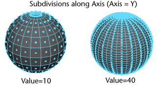

Almost all primitives allow you to subdivide along the height axis. The exception is the helix, which subdivides per coil instead.

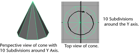

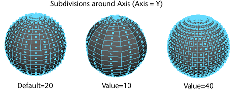

Primitives with radial symmetry allow you to subdivide around the axis. These include spheres, cylinders, cones, tori, pipes, and helixes.

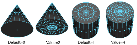

Primitives with caps allow you to subdivide the caps. These include cylinder, cones, pipes and helixes.

This option defines the number of subdivisions there are around the axis. This option is called Subdivisions Axis in the Channel Box and the Attribute Editor.
Increase or decrease this value to add or take away faces around the axis defined by the Axis option.
This option defines the number of subdivisions there are along the axis defined by the Axis option. Height is equivalent to the Y direction by default. This option is called Subdivisions Height in the Channel Box and the Attribute Editor. Increase or decrease this value to add or take away faces in the Axis direction.

Caps are the tops, bottoms, or sides of cones, cylinders, prisms, pyramids, pipes, and helixes. This option defines the number of subdivisions around the origin of the primitive caps. This option is called Subdivisions Cap in the Channel Box and the Attribute Editor. Increase or decrease this value to add or take away faces around the caps.
This option allows you to create a round surface for the cap. Your Subdivisions Cap value must be one or greater to see the round cap effect. This option applies to the Cylinder, Cone, Pipe, and Helix primitives.
