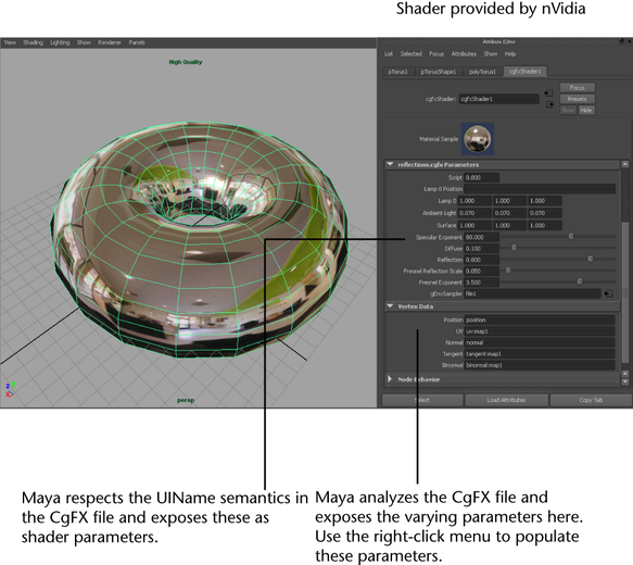

Maya supports Cg version 3.0.015.
CgFX examples are shipped with Maya LT. You can find these examples at:

Select a Maya_*.cgh code example; for example, maya_blends.cgh, the code that Maya uses for blending of the layered texture:
You can use the MAYA_CGFX macro to customize your CgFX shaders to include Maya specific attribute annotations without breaking the compatibility with other applications that might also use the same CgFX shader.
For example, you can use the following code to declare the directional light attribute in both Maya and another application without causing any compatibility issues:
