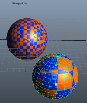

If you enable the Consolidate world option under Options > Viewport 2.0 > , CgFx plug-ins that depend on local vertex position may not behave as expected.
In the example below, the check3d.cgfx shader applies the 3D checkerboard pattern to the object relative to the position of the surface in the local space of the object, and therefore may produce unexpected results in Viewport 2.0. The same shader is applied to both spheres but the checkerboard pattern moves when you tumble the scene or select the spheres when Consolidate world is turned on.
