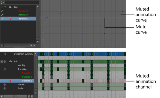

To mute channels in the Dope Sheet or Graph Editor
A Mute curve or channel appears in the view area.
A red icon appears beside a channel name when it is muted. A green icon appears beside a channel name when it is not muted, but is still connected to a mute node. When the mute node is set to off in the Channel Box, the green icon still appears beside the channel’s name in the Graph Editor.
You can view, manipulate, and add keys to this mute channel or curve in the Dope Sheet or Graph Editor. This is useful when you want to isolate and review specific parts of your animation. When you edit a mute channel or curve, its corresponding animation curve automatically updates in the Dope Sheet and Graph Editor view areas.
