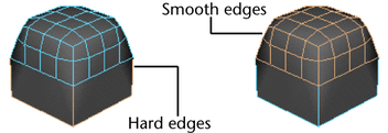

If you select edges, Smoothing options are made available. These Properties options do not display for any other component type.
Click one of these options to constrain the selection to either hard or soft edges.

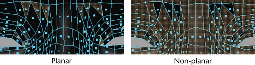

Select either planar or non-planar faces.
Planar selects only planar faces. Non-planar selects only non-planar faces.

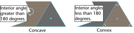

Select polygons based on the angle of their sides.
Concave selects polygons that have at least one interior angle greater than 180 degrees. Convex selects polygons whose interior angles are all less than or equal to 180 degrees.

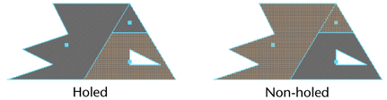

Select faces based on whethe they have a hole or not.
If you select non-holed, only faces that do not have holes are selected. If you select Holed, only faces in which holes have been created (using ). For more information, see Make Hole Tool Options.

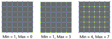

Maya selects the vertices with no fewer than the Min number of edges connected to them and no more than the Max number of edges connected to them.
