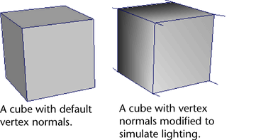

Lets you adjust the user-defined normal of a vertex (or several selected vertices) using a manipulator. For example, you can make sharp edges appear smoother or adjust the lighting on a polygonal object by modifying the direction of the vertex normal.
Editing the vertex normal with this tool overrides the existing Maya normals for the mesh and locks the user-defined normal you set. You can unlock the user-defined normal using Mesh Display > Unlock Normals.
