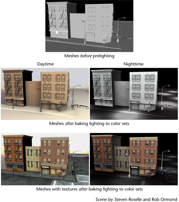

For example, you can pre-light your scene by baking your daytime lighting to one color set and then your night time lighting to another color set for each polygonal mesh in your scene.

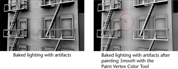

You can also touch up your baked lighting results by painting vertex colors directly into your color sets. The Paint Vertex Color Tool lets you remove, replace (darken or lighten), or smooth the lighting baked on your vertices. See Assign colors to polygon vertices by painting.
