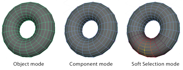

To select components
Tip: You can also select components in Soft Selection mode (press B). This is useful for sculpting smooth objects or smoothly adding integrated slopes or contours to your geometry without having to transform each vertex manually.
Watch the video below for information on how to select object components in different ways.
