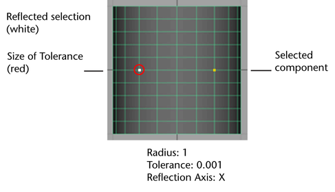

Sets how closely the selected component and the component across the symmetry axis have to mirror each other in order to be considered symmetry. It only has an effect when Soft Selection is turned off.
When the value is set very low, a component must be almost exactly mirrored across the seam to be considered symmetry. Higher values allow the component’s position to vary slightly and still be considered symmetry. Increasing the Tolerance is useful when you want to select reflected components on a mesh that isn’t quite symmetrical.
The Tolerance value should only be a small fraction of the distance between components. For example, if each vertex is 0.1 units from the vertex next to it, then a Tolerance of 0.001 is appropriate.

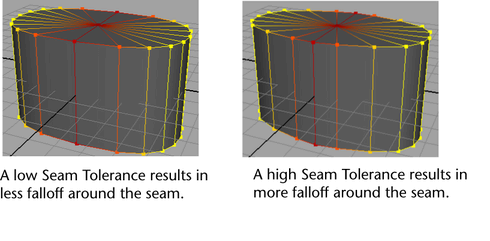

Sets the falloff around the symmetry seam when Preserve Seam is on. This controls how smooth transformations near the seam appear when components on the seam itself cannot be transformed away from the axis of symmetry.
Higher values increase the amount of falloff making your transformations near the seam smoother.
