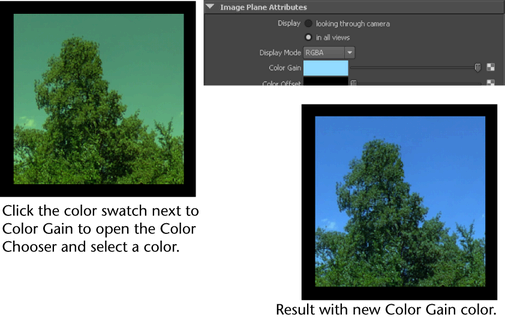

A scaling factor applied to all colors in the image plane. Maya multiplies all colors in the image plane by the Color Gain color. For example, you can color correct an image plane that appears too green by setting the Color Gain color to a shade of blue. The default color is white (no effect).
An offset factor applied to all colors in the image plane. Maya adds the Color Offset color to all colors in the image plane. For example, you can brighten an image plane that appears too dark by dragging the slider to set the Color Offset color to a shade of grey. The default color is black (no effect).

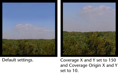

The Placement Extras attributes control which portion of an image file is visible on the image plane. If Image Plane is Fixed, the Placement Extras attributes also control the position and size of the image plane.
The number of horizontal and vertical pixels of the image file displayed on the image plane. The default values for Coverage X and Coverage Y are the horizontal and vertical resolution of the image file. By decreasing these values, you can limit the portion of the image file that is displayed.
The horizontal and vertical value of the pixel in the image file displayed in the bottom left corner of the image plane. By changing the Coverage Origin X and Coverage Origin Y values, you can scale and offset the image file on the image plane. The default values are both 0.
The following diagram shows what happens to the image plane placement when you adjust Coverage attributes:

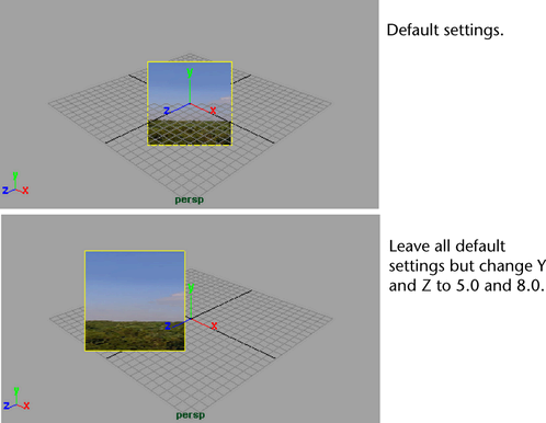

The position of the center of the image plane (measured in the scene’s linear working unit). Center is not available if Image Plane is Attached to Camera.
The width and height of the image plane (measured in the scene’s linear working unit). Width and Height are not available if Image Plane is Attached to Camera.
The following diagram shows what happens to the image plane placement when you adjust center, width, and height attributes:
For free image planes (Create > Free Image Plane), the Width and Height values are both set to 10.0 by default. After an image is attached to the free image plane, the width and height values are set to the original image size divided by 100. For example, an image of size 1600x1200 has a Width of 16 and a Height of 12.
