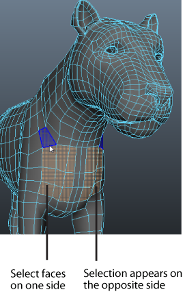

Symmetry in Maya is selection-based. When symmetry is turned on, the selected component(s) and the component(s) on the opposite side of the mesh are included in the selection, letting you perform selection-based polygonal modeling operations with symmetry.
