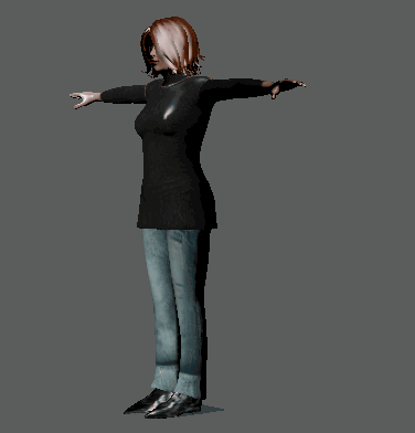

  1. Start with an empty character mesh.

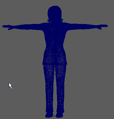

  3. Expand 1) Geometry to choose the mesh(es) for rigging and click Select All Meshes to locate all meshes in the scene.
    Note: Some meshes have auxiliary meshes that accompany them, for example, eyes, hair, accessories, and so on. Use the Select All Meshes option to make sure that these are selected as well.
  4. Select Add Selected Meshes to populate the Geometry list with the selected meshes.

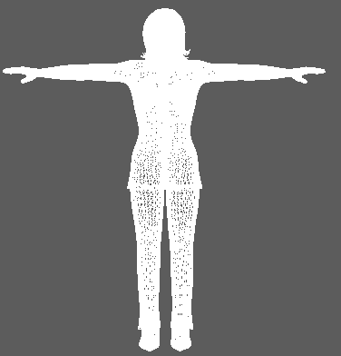

  5. In the 2) Guides area, choose the Embed Method that best suits your mesh.
    Note: The Imperfect Mesh Embed Method is the default as it is a general good fit for most meshes. Click the help icon or see Quick Rig tool for an explanation of each segmentation method.
  6. Choose a resolution from the Resolution list.
    Note: Higher-resolutions take more time to process.
  7. Use the Symmetry option to force the guides to align within the bounding box of the selected mesh(es).
    Note: Make sure that the guides that map to center joints (hips, spine, and neck) are centered and are aligned symmetrically on shoulders, arms and legs.
  8. Use the Center settings to specify which guides will generate your character.
  9. Click Create/Update to add guides to your character mesh. (Click Delete Guides if you want to start over.)

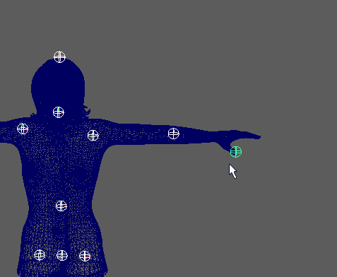

  10. Expand 3) User Adjustment of Guides and reposition the joint guides to better fit your mesh. (See Quick Rig tool for a description of each guide adjustment icon.)
