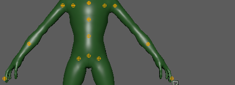

- Guides area
- Guides are helper markers that you use to align the rig.

- Guide Settings
- The area assigns guides that help
Maya LT align the skeleton joints with the appropriate positions on your mesh.
- Symmetry
- Ensures that guides map to center joints (hips, spine, and neck,) are centered and map to symmetrical joints (shoulders, arms and legs).. The center/mirror plane is the YZ plan that passes through the center of the mesh(es) bounding box. It is recommended to leave this option turned on unless your character is intended to be unequally proportioned.
- Center
- Lets you set how many guides the skeleton will use to create the rig. The default HumanIK skeleton has 3 spine nodes, and one neck and shoulder/clavicle each.
Note: If you enter a number in the Spine field and then count the guides in the
Outliner, it appears that there is one spine guide
less than you specified. This is because the last spine guide is named
shoulders, and is the joint between each shoulder. It occupies the same position as the last HIK spine joint.
- Create/Update
- Click
Create/Update to add guides to your character mesh.
- Delete Guides
- Clears guides from the character mesh.
- User Adjustment of Guides area
- You can manually position the guide helpers that
Maya LT uses to create the skeleton to achieve a better match with your character mesh using the
Move tool. Use the options below to help with positioning.
- Mirror Left to Right/Mirror Right to Left
- Uses the position of the selected guides to align the opposite side's guides. Center guides are snapped to the mirror plane
Note: The Mirror Left to Right tool uses the selected guides on the character's left side when facing the character (that is, guides on the character’s right side) and applies a mirror plane offset to its symmetrical counterpart on the character's right side when facing the character (that is, on the character’s left side).
The Mirror Right to Left tool works in the opposite way.
- Select Guides
- Selects all the guides.
- Show/Hide all Guides
- Toggles the display of guides on and off.
