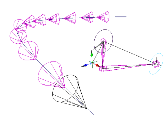

A constrained object is an object whose position, orientation, and so on is driven by the nearest surface location, the direction of a target vector, or the position of one or more target objects. The position of one or more target objects is called the target point. The orientation of one or more target objects is called the target orientation.
The target point is the position of the target object’s rotate pivot. If there is more than one target object, the target point is the average position of the rotate pivots of all the target objects. If you are using more than one target object, you can vary the influence of each target object on the calculation of the target point. The target point can be a weighted average of the positions of the target objects, with some target objects having more influence than others. The influence of target objects on the weighted average is specified by target object weights. You can change the target point by moving each target object’s rotate pivot.
The target orientation is the orientation (Rotate X, Y, and Z attributes) of the target object. If there is more than one target object, the target orientation is the average orientation of all the target objects. However, if you are using more than one target object, you can vary the influence of each target object on the calculation of the target orientation. The target orientation can be a weighted average of the orientations of the target objects, with some target objects having more influence than others. The influence of target objects on the weighted average is specified by target object weights.
The target scale is the scaling (Scale X, Y, and Z attributes) of the target object. If there is more than one target object, the target scale is the average scaling of all the target objects. However, if you are using more than one target object, you can vary the influence of each target object on the calculation of the target scale. The target scale can be a weighted average of the scales of the target objects, with some target objects having more influence than others. The influence of target objects on the weighted average is specified by target object weights.
The target vector, or weighted average vector, represents the normal vector at the position of the constrained object. Maya calculates the target vector as a weighted average of the nearby normal vectors on the surface or mesh.
For each target object, you can specify a target object weight that controls that object’s influence in the calculation of the target point, orientation, scale, vector and so on. The resulting weighted average drives the constrained object’s position, orientation, and so on. When a target object’s weight is 0, the target has no influence over the constrained object. When the target object’s weight is 1, the target has full influence over the constrained object.
The constrained object’s position is driven by the target point. However, you can offset the constrained object’s position from the target point. Offsetting the constrained object’s position from the target point can be useful in situations where you don’t want the local axis of the constrained object to coincide exactly with the target point. For example, if you want to constrain a ball to a joint in a character’s hand so that the hand holds the ball, you’ll need to offset the ball from the joint. By offsetting, you can have the ball in the palm of the hand rather than centered inside the hand.
