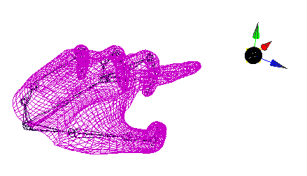

An aim constraint constrains an object’s orientation so that the object aims at other objects. Typical uses of the aim constraint include aiming a light or camera at an object or group of objects. In character setup, a typical use of an aim constraint is to set up a locator that controls eyeball movement.

The aim vector constrains the constrained object so that it always points at the target point. The aim vector starts at the constrained object’s pivot point and always points at the target point.
How the object rotates to point at the target point depends on how the aim vector is defined relative to the object’s local space. For instance, by default, the aim vector is defined so that it points in the same direction as the local rotation positive X-axis. Consequently, by default, a constrained object’s local rotation positive X-axis will point at the target point.
