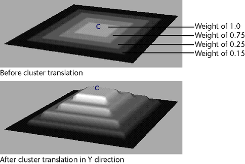

After you create the cluster, set up the percentages based on the amount that you want the points or control vertices to be affected.
For some cases, you may set one percentage for the whole object. For example, a stick on moving water, in which the cluster handle is set to move at 50% of the transformation of the water.
At other times, you may want some parts of the geometry to be affected more or less than other parts. For example, you could have a scene with waving trees, where the treetops are affected the most, and the trunk near the ground affected by 0%.
Using the Paint Cluster Weights Tool, you can set cluster weights simply by painting over the clustered surface. Although you can transform the cluster first, then paint weights on the surface, the Paint Cluster Weights Tool provides color feedback so you know which parts of the clusters have different weights before you transform the cluster. Weights display as a range of grayscale values, with a weight of 1 displaying as white and 0 as black. See Paint Cluster Weights Tool.

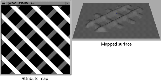

Using the Paint Cluster Weights Tool you can map attribute values onto surface vertices relative to the UVs. The settings for the tool are applied to the cluster vertices using the mapped values.
In the following example, notice that only the cluster is affected by the map.
