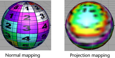

When you map a 2D texture, you can choose the mapping technique Maya uses to apply the texture to the object: normal, projection, or stencil. By default, textures are mapped as a normal map.
The texture is mapped to the UV space of the surface and is sized and positioned depending on the UV parameterization of each surface.

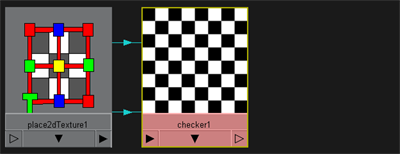

The shading network for a Normal 2D texture map is made up of the file texture node and the place2DTexture node that defines the texture’s placement.
This mapping technique projects the texture through 3D space like a slide projector.
When you create a projected 2D texture, it behaves like a 3d texture (it has height, width, and depth).
The shading network for a Projection 2D texture map is made up of the file texture node and a Projection node that defines the texture’s placement.
