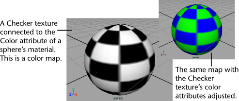

Maya LT has a number of textures that you can map onto objects. For more information on these textures, see 2D and 3D textures.
For example, if you connect Maya LT’s 2D black and white Checker texture to the color attribute of an object’s material, you have applied a color map; the checkered pattern determines which parts of the object appear black and which appear white (or other colors if you adjust the texture’s color attributes).
To map a texture, see Map a 2D or 3D texture.

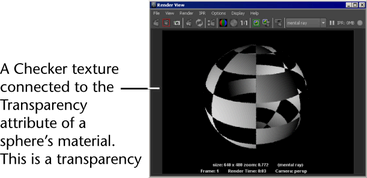

If you connect the black and white Checker texture to the transparency attribute, you have applied a transparency map; the checkered pattern determines which parts of the object are opaque and which are transparent.

By mapping a texture to the Color attribute of an object’s material, you create a color map which describes the color of the object.
To learn more about how you can work with color, see Common surface material attributes.
By mapping a texture to the Transparency attribute of an object’s material, you create a transparency map which lets you make parts of an object opaque, semi-transparent, or entirely transparent.
To learn more about how you can work with transparency, see Common surface material attributes.
