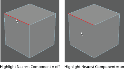

Highlight Nearest Component
When on, highlights the closest component to the cursor before you select it. By default,
Highlight Nearest Component is turned on in the
Modeling Toolkit and the
Select Tool settings. When
Highlight Nearest Component is turned off, components are only highlighted when your cursor is placed on top of them.
