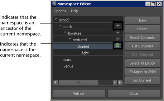

The Namespace Editor displays all the current namespaces, including nested namespaces, in your scene. The root namespace is denoted with ":(root)" .

| Set the current namespace | Select the namespace you want to set as the current namespace, and then click Set Current. A icon indicates the currently set namespace. |
