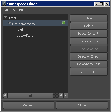

To create a namespace using the Namespace Editor
The Namespace Editor appears.
Maya creates a new namespace.
The Rename Namespace window appears.

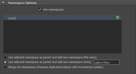

When importing a file, you can create the namespace used by the referenced and imported objects.
To create a namespace during import
The Import Options window appears.
In the case where duplicate namespaces occur, the namespaces are merged and duplicate object names are incrementally suffixed with a number. Use this option to avoid an accumulation of new namespaces each time your referenced or imported objects have the same namespace.
