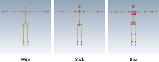

Edit Control Rig
Rig Look
Lets you select what style of Control rig effectors to work with.
