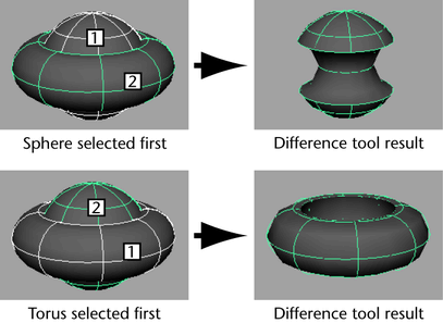

The order in which you click the surfaces only matters for the Difference tool. Maya subtracts the second surface you click from the first.

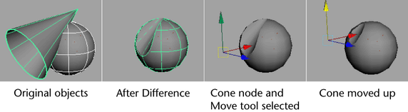

You can make the following adjustments after creating the Boolean shape:
The only way to retrieve the original objects after a Boolean operation is to use Undo.
