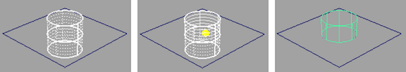

A “trim grid” appears on the surface.
As you click, regions that will be trimmed away are dotted, and regions that will be kept are solid.
