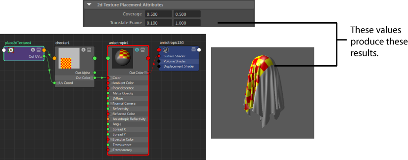

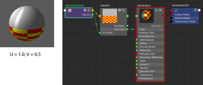

Specifies what ratio of the surface the texture map covers. The valid range is 0 to + infinity for NURBS surfaces. A value of 1 (the default) covers the entire surface in either the U or V direction.
For example, to cover half the surface, set the value at 0.5 in either the U and V directions.
The Translate attributes position the texture map on the surface and move the coverage area across the surface. The range is from - infinity to + infinity.

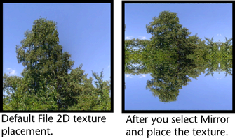

Only works when U Repeat or V Repeat attributes are greater than 1. Mirror in the U and V direction separately. When on, the repeat areas are mirrored—rows of images display as mirrored images of themselves. This helps to disguise the effect of seams between repeat areas.

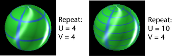

Specifies how many copies of the texture map are mapped within the coverage area along either the U or V directions (depending on the texture). By default, Maya maps one copy of the texture. Values greater than 1 result in more copies of the map displayed in the same coverage area. Values less than 1 result in only a portion of the map displayed.
