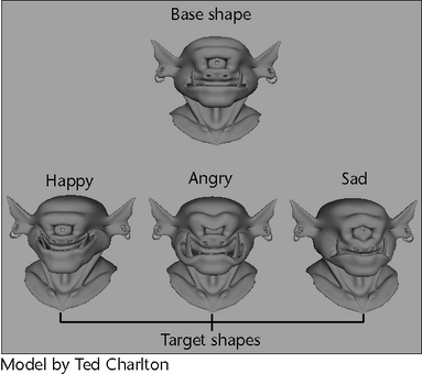

This tool lets you set blend shape weights on a per vertex basis, giving you finer control over the amount of influence the target shapes have on the base shape. This tool also lets you paint the weights for each target shape, and lets you mix target shapes and create partial targets.

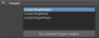

  6. In the Target section, select the target shape whose weights you want to paint on the base shape from the list of targets. This is the same target shape whose weight you set to 1 in the Shape Editor.

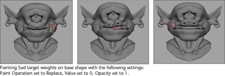

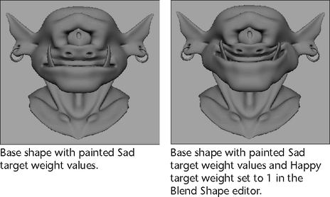

  7. In the Paint Weights section, adjust the Value and Paint Operation tool settings and paint the selected target’s weights on its base shape to create the deformations you desire.

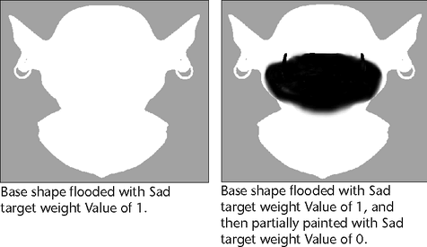

    By default, your base shape is flooded with a Value of 1.
    A Value of 1 (full influence) appears as white painted weights and a Value of 0 (no influence) appears as black painted weights. All other Value settings appear as different shades of gray.

    • In the Paint Blend Shape Weights Tool settings, select the target shape whose painted blend shape weights you want to key from the target list, then click the Key Selected Target Weights button.
      This button keys the painted blend shape weights for the target shape selected in the target list.
To create a new target shape from the painted base shape
  1. Follow the steps in the previous procedure until you have created a deformation that you want to save as a new target shape.
  2. Select your deformed base shape, then select Edit > Duplicate.
    A copy of your deformed base shape appears over your base shape.
  3. Select the Move Tool and drag the copy of your deformed base shape away from the original base shape.
  4. Rename the copy of the deformed base shape using the naming conventions of your current target shapes.
  5. Select the copy of the deformed base shape and then Shift-click the original base shape.
  6. Select Deform > (Edit) Blend Shape > Add > to open the Blend Shape Add Options.
    The copy of the deformed base shape you created is added as a new target shape to your blend shape deformation.
