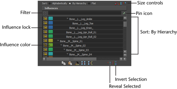

These options let you set how joints are displayed in the Influences list. Select from the following options:
Sorts the joint names alphabetically.
Sorts the joint names by hierarchy (parent-child) and displays them as branches that you can expand and collapse. The top of the list shows the root joint of the hierarchy.
This option is useful if you are painting a single a region of the skin—the joints you need to select from the list while painting are typically next to one another.
Sorts the joint names by hierarchy, but displays them in a flat list. Parent influences still display above child influences in the list, but you cannot expand and collapse the influences.
Resets the Influences list to the default size.
Click to expand the Influences list and display more rows.
Right -click the button to open the Row Increments Options window and set how many more rows to display with each click.
Click to shrink the Influences list and display fewer rows.
Right -click the button to open the Row Increments Options window and set how many fewer rows to display with each click.
This area displays a list of all influences bound to the selected mesh. For example, all joints that influence skin weights for a selected character mesh.
Within the Influences list, you can use the following controls.
Enter text to filter the influences that display in the list. This can make it easier to locate and select influences you want to work with, especially if you have a complex rig. For example, enter r_* to list only those influences that have the prefix r_.
Pins the influence list to display only the selected influences.
Lets you lock and unlock each influence from receiving weight as you paint.
Opens the Influence color window, which lets you assign a new color to the selected influence.
Click to copy the weight value of a selected vertex. See Copy smooth skin weights.
Click to paste a copied vertex weight value to other selected vertices.
Click to fix selected vertices that have weights causing undesirable deformation on the mesh. Maya assigns the selected vertices with the same weight values as their neighboring vertices, resulting in smoother deformation. See Fix smooth weights.
Click to move the weight values of selected vertices from the first selected (source) influence to other selected (target) influence(s). See also Move weights to other influences.
When you click the Move weights button (or select Skin > Edit Smooth Skin > Move Weights To Influences), the weight values of the selected vertices are removed from the selected source influence and re-assigned to any selected target influence(s).
Click to select all influences that affect the selected vertices. This can help you troubleshoot areas of the mesh where you find unexpected deformations.
Click to quickly reverse which influences are selected in the list. This option is useful in conjunction with the Influences list hold and un-hold buttons.
For example, select only those influences you want to work with, then click Invert Selection to change your selection to all other influences in the list. You can then click to hold all other influences.
Click to automatically scroll the Influences list to display the selected influence. This can be helpful when working with a complex character that has many influences.

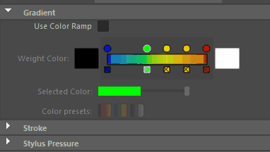

When on, weight values are represented in color on the mesh. This can make it easier to see small values when painting, and to determine whether a joint is influencing vertices where it should not. For more information on using color ramps, see Set attributes using ramps.
When Use color ramp is on, you can use the Weight Color ramp and Selected Color options to customize the color ramp. You can also select one of the Color Preset options.
When Use Color Ramp is on, this area lets you edit the color ramp. Click the swatches on either side of the ramp to set colors to represent values of 0 and 1, or select part of the ramp and click the Selected Color swatch to re-set that color.
Click to open the Color Chooser window and set a new color for a selected part of the color ramp. Only available when Use color ramp is on.
Select from three pre-defined color ramp options.
