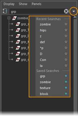

- Click the triangle at the right end of the Search field to open the Searches list. The Recent Searches list shows you the 10 most recent search strings you've entered - click one to use it again.
To save search strings
- Open the Searches list.
- In the Recent Searches list, click the star beside the search string you want to save. This string is added to the Saved Searches list below and its star turns blue.
You can save up to 10 search strings. If you try to save more than 10, a message informs you that you need to remove items from the Saved Search list in order to add new ones.
- Click this string's star again to remove it from the Saved Searches list.
