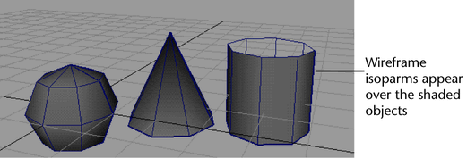

Wireframe on Shaded
Superimposes a wireframe display on all shaded objects in a view.

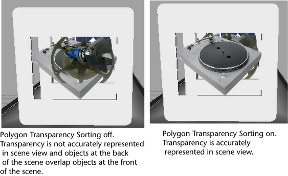

Object Transparency Sorting
Transparent objects are sorted and drawn from furthest to closest in distance. This option provides faster results but may not render complex transparent objects correctly.
Polygon Transparency Sorting
Each object's polygons are sorted and drawn from furthest to closest in distance from the viewer. This option provides more accurate transparency representation but may take longer to process.
