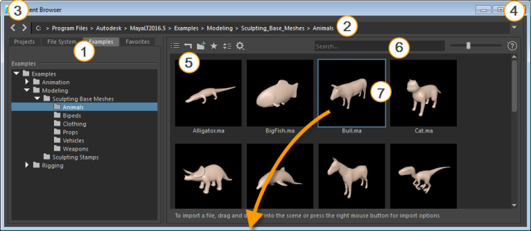

Navigating the folders
Expand the folder structure in the browsing panel on the left and select a folder to display its contents in the Content panel on the right.
Note: By default, the
Content Browser opens to the
Examples tab, but the next time you open it, it goes to the last location you selected.
Element in Content Browser
Lets you do this
1: Tabs in the browsing panel
Find the location of the data you want to load, then expand the folder structure and select a folder to display its contents in the Content panel:
- Projects displays your project in a tree view. By default, it displays the current project, but you can select another one from the
Current Project list at the top of this tab.
Click the
Set Project button at the bottom of this tab to open a browser in which you can select and set a different project as current, or click the
Project Window button to open the
Project Window in which you can create a new project or modify the existing one.
- File System displays your local or network directories in a tree view.
- Examples displays a library of example content from the
Maya LT installation
\Examples folder.
- Favorites displays folders and files you have added as favorites.
See
Customize the Content Browser for information about adding to the
Favorites tab and creating your own folders there.
2: Path bar
Select or enter an absolute path to find content:
- Click a folder name in the path bar to open that folder directly.
- Enter an absolute path name in the path bar to open that folder. This can be path to a folder that is local or on a network.
3: Back/forward arrows
Navigate among the previous and next locations you have already visited.
4: Navigation arrow
Open a menu that displays the recent navigation history. Select a location to go to it.
5: Go Up One Directory Level icon
Click the
icon in the Content panel to open the directory above the current folder and display its content in the Content panel.
6: Search field
Search the contents that are currently displayed in the Content panel - see below for details.
7: File
Import a file into your scene in different ways, such as by dragging and dropping it into a view panel.
