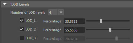

If you find that the default LOD switching threshold values don't produce the results you want, select the LODn_group node and adjust the default values for triggering each level. For example, to make the switch to LOD_2 happen when the object is further away, change LOD_2_Display Start to a higher value.
Zoom in and out in the scene to test your changes.
