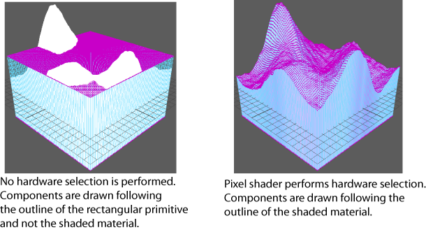

New for Maya 2016 Extension 1
The technique NormalView_Selection demonstrates how to perform hardware selection on displaced components, and to render non-material items (such as wireframe and selected edges/vertices) at their displaced positions.
Hardware selection allows you to select tessellated geometry. In addition, wireframe and components draw with the same outline as the shaded material in the viewport. This technique has 7 different passes.

The first 4 passes are used for drawing in the viewport; therefore the PS_Normal and PS_SolidColor pixel shaders are used.
Pass pNonMaterialItems: renders components such as wireframe and vertices. Components are rendered with a solid color, such as blue for edges of dormant objects and light green for edges of active objects.
Pass pNonMaterialItemsFatLine: renders lines using the GS_FatLine geometry shader.
Pass pNonMaterialItemsFatPoint: renders points using the GS_Point geometry shader.
The last 3 are used to render components during hardware selection, and therefore the PS_HWSelection pixel shader is used. The PS_SolidColor pixel shader is not used, as these passes are not used to draw in the viewport.
A primitive id (such as vertex id) is used to produce a color to identify the object that is picked. An offscreen buffer is used to store these computed colors so that Maya knows what is picked by the mouse.
Pass pNonMaterialItemsSelection: used for selection of components such as wireframe and vertices.
Pass pNonMaterialItemsSelectionFatLine: used for selection of fat lines
Pass pNonMaterialItemsSelectionFatPoint: used for selection of fat points.
