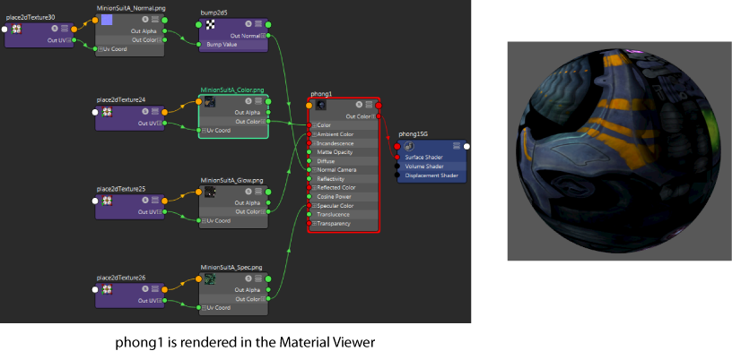

The Material Viewer displays any shading network, including materials, textures, and utilities, based on the context of what is graphed in the Hypershade work area. A red border highlights the node that is currently rendered in the Material Viewer.
As you adjust your shading network, the Material Viewer updates in real-time.
In this example, you can select any node in the graph to see the downstream result of the network (phong1) in the Material Viewer. The node that is rendered in the Material Viewer is denoted by a red border.

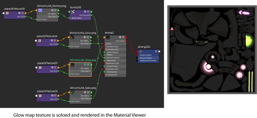

To view a particular texture, click the S icon on the file node to solo the node. For more information about soloing, see About soloing. You can also select your textures in the Textures tab of the Browser and render them in the Material Viewer. When rendering textures, the Material Viewer swatch appears in flat view.

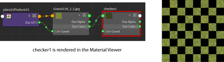

In this example, checker1 is rendered in the Material Viewer. To see the grass reference texture in the Material Viewer, solo the file node.

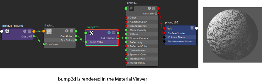

You can render a bump map in the Material Viewer, and it appears as a 3d geometry swatch to allow you to better examine the bumps under the influence of lighting.
