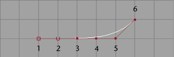

The higher the Curve Degree, the smoother the curve. The default setting (3 Cubic) works well for most curves. You must create at least one more CV than the Curve Degree number. For example, you need at least six CVs to complete a degree 5 curve:

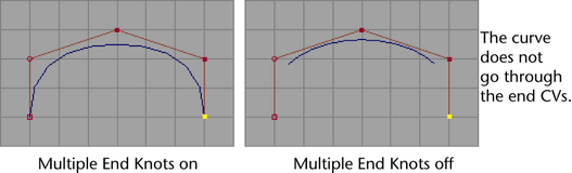

When turned on, the curve’s end edit points (knots) are superimposed on the end CVs. Generally, this makes the curve’s end region easier to control.
If you create a pair of curves with Multiple End Knots off, you can use Snap to Points to align the second CVs (next to the end CVs) of each curve to create tangent continuity between the two curves.
