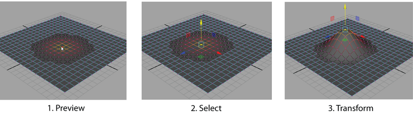

  3. In your scene, move your cursor over the mesh to preview the falloff area.
    The falloff area is represented by a color gradient. The gradient is applied to all of the components that are within the falloff area.
  4. Resize the falloff area in one of two ways:
    • b + middle-drag left or right to increase or decrease the size of the falloff area starting from 0.
    • b + drag left or right to resize the falloff area starting from the last radius value.
  5. Select a component.
    All components within the falloff area are selected and the selected transform tool manipulator appears.
  6. Use the manipulator to transform the components located within the falloff area.
