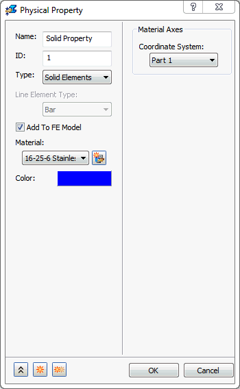

Define the Element Properties
Right-click on
Physical Properties
in the Autodesk Nastran In-CAD tree view and select
New
In the
Physical Property
dialog, type
Solid Property
for
Name
, select
Solid Elements
under
Type
Then click
OK
. The material
16-25-6-Stainless Steel
is added to the
Physical Property
list.

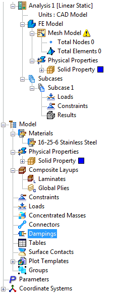

The tree view should now look as shown below.
