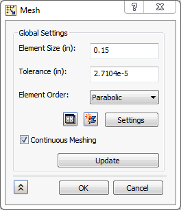

Define the Mesh
Right-click on
Mesh Model
and select
Edit
Change the
Element Size
to
0.15
Click
OK
. The model should look at shown below.

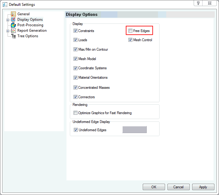

To remove white color edges, go to
Default Settings
, then
Display Options
, and uncheck
Free Edges
