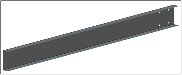

Linear Static Analysis of a Channel Using Shell Elements
This tutorial demonstrates the steps to set up a linear static analysis of a channel using shell elements as well as the following:
  1. Defining two enforced displacement loads for use in two subcases.
  2. Extracting the reaction loads and the load required to enforce the displacements.
