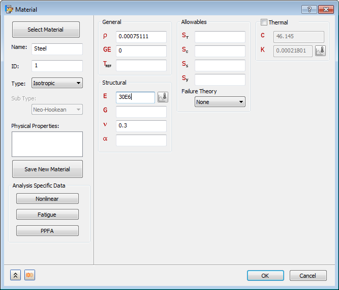

Define the Material Properties
Right-click on
Materials
and select
New
Change the
Name
to
Steel
Enter
30E6
into the
Young’s modulus (E)
input box and
0.3
in the
nu (ν)
input box.
Click
OK
