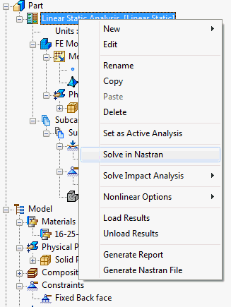

Run the Analysis
  1. Right-click on Linear Static Analysis in the tree and select Solve in Nastran.
  2. This option runs the model and saves the analysis file with a default name of Bath Fitting.NAS . Notice that this is the name that you saved the part as.
