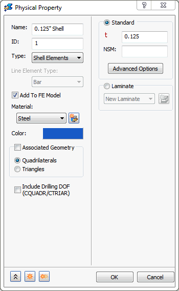

Define the Element Properties
Right-click on
Physical Properties
and select
New
Change the
Name
to
0.125” Shell
Select
Shell Elements
from the
Type
drop-down menu.
Select the
Standard
radio button and input
0.125
in the
t
(thickness) input box.
Click
OK
