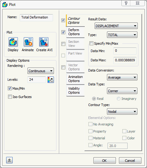

- Right-click on
Results and select
New.
- The figure below shows the default template options.
- You can name the plot and check or uncheck various display types on the left side of the dialog window.
- In the
Contour Options section,
Result Data can be chosen to be displayed.
Data Max and
Data Min values can be adjusted to modify the contour plot by checking the
Specify Min/Max checkbox.
- In the
Deform Options section, different deformation
Vector options can be chosen to be displayed. The
Deformation Scale can be set to
Percent or
Actual.
- Various
Rendering types are available such as
Continuous,
Fringe etc.
- Change the
Name at the top to
Total Deformation.
- Click
OK.

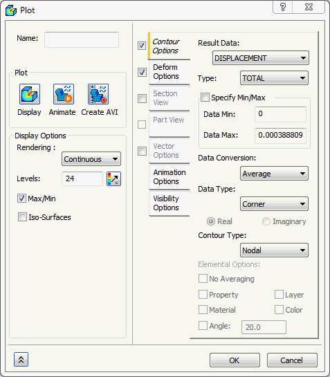

Results Plot Description:
- If the
Name box is empty and you click
OK, the
Result vector name is added automatically.
