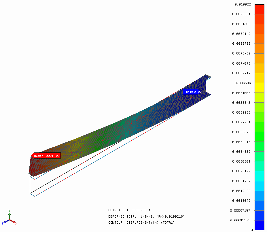

Post-Process the Results
  1. When the analysis completes, double-click on Displacement under Subcase 1 to see the deformed and contour plot of the beam under the Y Displacement load. Loads and constraints are turned off for image clarity.

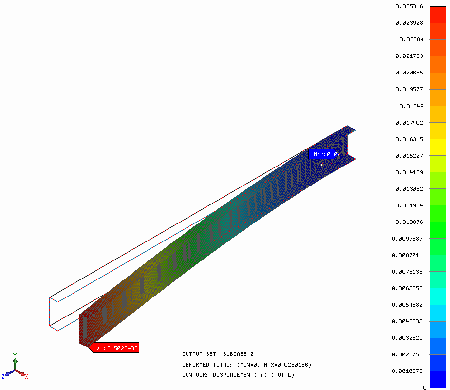

  2. Then check out the deformed and contour plot of the beam under the X Displacement load.
