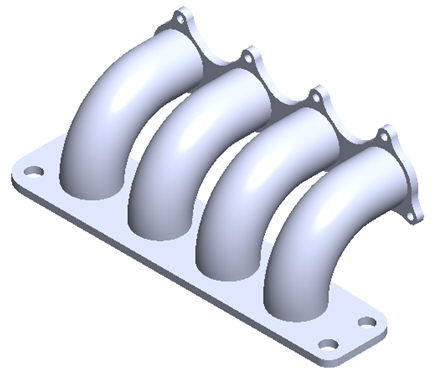

Heat Transfer and Thermal Stress Analysis of An Exhaust Manifold
This tutorial demonstrates two analyses: nonlinear steady state heat transfer and thermal stress. The model is an exhaust manifold made of steel. The goal of this problem is to get a temperature distribution based on the applied thermal loading from the nonlinear steady state heat transfer analysis, and then use that temperature distribution to determine the effects on the part due to thermal expansion.
