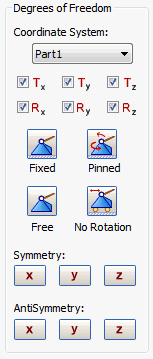

There are multiple buttons that, when clicked, automatically check the structural degrees of freedom to be constrained. For example, a Fixed constraint would check all boxes as shown in the figure below.

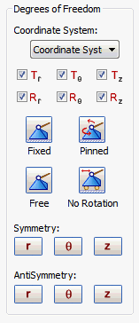

The Coordinate System pull-down menu allows you to apply a constraint in a custom coordinate system.
The example in the figure below illustrates its use.
The constraint in this example is applied in the custom cylindrical coordinate system in the theta direction.
Notice that the degrees of freedom are renamed based on the coordinate system type, like , and for radial, theta and z constraints respectively in a cylindrical coordinate system.

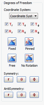

When a spherical coordinate system is assigned in the Constraint dialog, the degrees of freedom , and for radial, theta and pi constraints respectively, look as shown below.

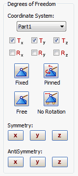

A Pinned constraint in a rectangular coordinate system would make selections as follows:

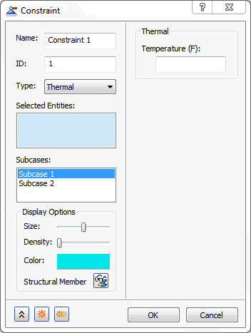

When the Type is Thermal, a fixed Temperature constraint can be applied to selected entities as shown in the figure below.
