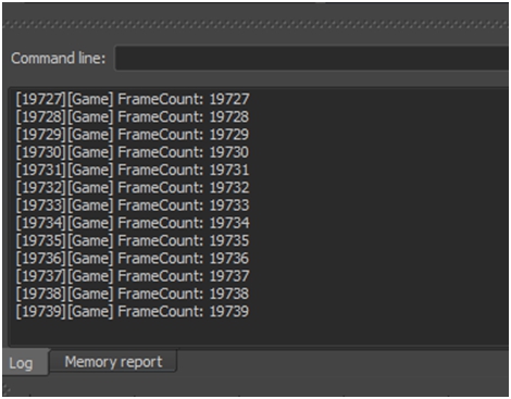

// Sends a message to the Log window of the Navigation Lab
static KyUInt32 framecount = 0;
KY_LOG_MESSAGE(("FrameCount: %d", framecount));
framecount++;

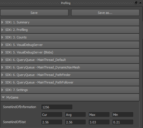

// Sends a single data value
KyUInt32 someKindOfInformation = 1256;
visualDebugServer->SendUInt32("SomeKindOfInformation", someKindOfInformation, myCategoryName);
// Sends current, average, max, and min stats computed by the game
const char* someKindOfStat = "SomeKindOfStat";
KyFloat32 currentValue = 2.56f;
KyFloat32 averageValue = 2.56f;
KyFloat32 maxValue = 3.026f;
KyFloat32 minValue = 0.21f;
visualDebugServer->SendStats(someKindOfStat, currentValue, averageValue, maxValue, minValue, myCategoryName);

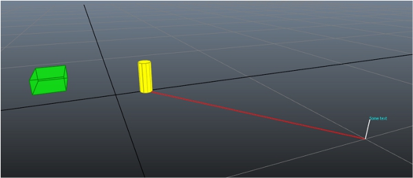

// Create a display list and send a line
Kaim::ScopedDisplayList displayList(m_world, Kaim::DisplayList_Enable);
displayList.InitSingleFrameLifespan("Simple Display List", myCategoryName);
displayList.PushLine(positionB, positionB + Kaim::Vec3f::UnitZ(), Kaim::VisualColor::White);
// The ScopedDisplayList is automatically sent to the Navigation Lab
// when it goes out of scope.
// Create a second display list and send more shapes
displayList.InitSingleFrameLifespan("Complex Display List", myCategoryName);
Kaim::VisualShapeColor shapeColor;
shapeColor.m_triangleColor = Kaim::VisualColor(255, 255, 0);
shapeColor.m_lineColor = Kaim::VisualColor(175, 175, 0);
displayList.PushVerticalCylinder( positionA, radius, height, 10, shapeColor);
displayList.PushLine( positionA, positionB, Kaim::VisualColor::Red);
shapeColor.m_triangleColor = Kaim::VisualColor(0, 255, 0, 128);
shapeColor.m_lineColor = Kaim::VisualColor(0, 128, 0, 255);
Kaim::Box3f someBox(boxLowerCornerPosition, boxLowerCornerPosition + boxExtents);
displayList.PushBox(someBox, shapeColor);
displayList.PushText( positionB + Kaim::Vec3f::UnitZ(), Kaim::VisualColor(0, 255, 255), "Some text");
// Again, the ScopedDisplayList is automatically sent to the Navigation Lab
#endif
}When you connect the Navigation Lab to your game, you should now see:

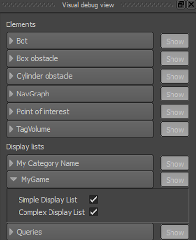

You can also show and hide the data sent in your display lists in the Visual debug panel. The category name you specified for your display lists is shown at the bottom of the panel, under the heading Display lists. If you expand this category, you can show and hide the individual display lists.
