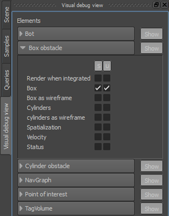

Each object that derives from the WorldElement class, such as Bots, dynamic obstacles, TagVolumes and points of interest, automatically sends data over the network to the Navigation Lab at each frame to indicate its current position, velocity, etc. By default, each object is configured to send only the most important, commonly used items of information, such as its current position, dimensions, velocity, etc. When you debug your game in the Navigation Lab, you can choose which items you want to view for each class of WorldElement in the Visual debug panel.

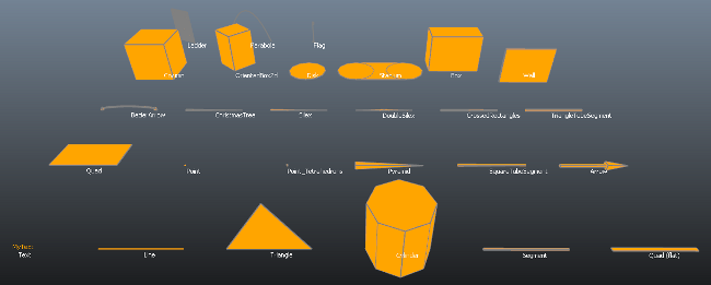

You can send your own 2D shapes and 3D volumes from your game to the Navigation Lab by setting up instances of the ScopedDisplayList class.
The API of the ScopedDisplayList class offers methods for creating a wide variety of common shapes and volumes.
For a visual legend, enter the following command into the command line of the Navigation Lab:

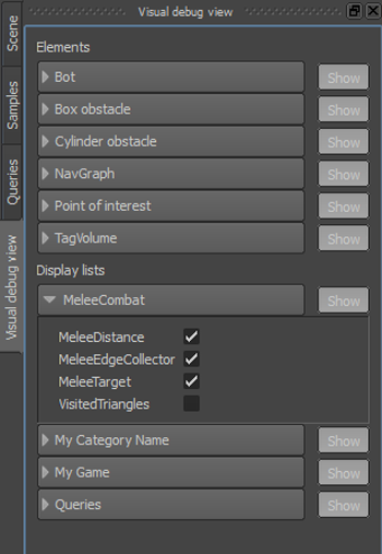

}Each time the Navigation Lab displays the data for a frame in your game, it lists all of the display lists valid for that frame under the Display lists heading in the Visual debug panel, organized by the category name you provided for your display lists. You can use these controls to toggle the visibility of each display list in the 3D view.
For example, in the following image, "MeleeCombat" is a category name that was set for display lists with different display list names like "MeleeDistance", "MeleeEdgeCollector", "MeleeTarget", and "VisitedTriangles". Each of those display lists has its own checkbox, organized under the shared category name.
