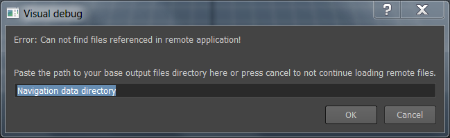

You will not immediately see the NavMesh in the 3D view of the Navigation Lab. This is normal; to avoid sending potentially large amounts of data across the network, NavData is not sent from the game to the visual debugger. However, it can be very helpful to load the NavData and geometry when debugging to see the debugging data sent from the game in context.
Therefore, the Navigation Lab prompts you to provide a path that contains the NavData files loaded into the game:

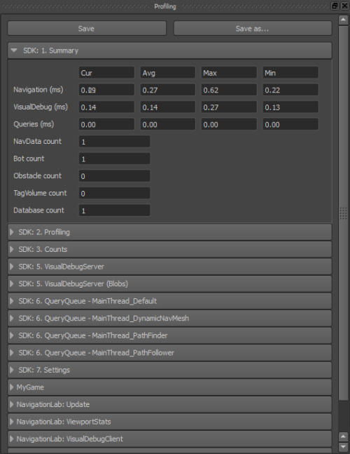

To verify that your NavData has been correctly loaded in the game, open the Profiling panel. In the Summary group, your NavData count value must be greater than 0. If you loaded your NavData into memory using the DefaultFileLoader as shown in the code example above, your Memory Footprint value will also include the size of your data.
