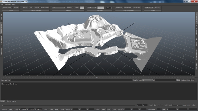

  2. Launch the Navigation Lab.
  3. Drag and drop your .obj file onto the 3D view of the Navigation Lab.

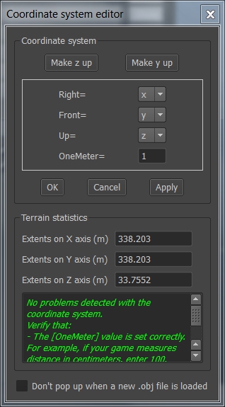

    A dialog box will be displayed for you to set up the coordinate system used in your game. Indicate which axes in your game's coordinate system are used for Up, Right, and Front coordinates. Also, use the OneMeter control to set the number of measurement units in your game that add up to one meter. This controls the scale at which your terrain is measured.
    If the Navigation Lab detects any possible errors in your coordinate system setup, it lists them in the editor window.
  4. Your terrain must appear with the correct orientation. If its orientation is not correct, adjust the coordinate system as necessary. Close the Coordinate System Editor when your terrain looks right.

  6. Click Generate. The Navigation Lab will generate the NavMesh for your terrain, and show it in the 3D view when the generation is complete.
    Statistics about the generation process are shown in the Log panel.
    Depending on the terrain you have chosen, you may see NavMesh generated in places that you do not want your characters to go in the game: on rooftops, treetops, the tops of walls, and so on. This is not a problem for now, but eventually you will want to use one of several possible strategies for excluding unwanted areas. See Identifying the Navigable Areas.
